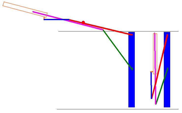

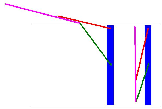

I've been trying to work out the link lengths to give decent height to the arm whilst maintaining an as-large-as-possible triangle at the bottom.
The ram would lift the red beam, until the pink and green beams are in line, nudging the green/pink joint towards the red beam, followed by lowering the red beam would lock the triangle off - meaning the strength of the ram wrt the load is irrelevant, what is relevant is the size of the triangle, I'm struggling to lower the bottom corner whilst maintaining a decent 'assembled' height for the arm. I reckon it's do-able tho.
The picture shows a reach of about 1.3x the 'bed to cab' height, I think this can be considerably improved.
It's been fun playing with cardboard anyhow.

LandyManLuke
Jan 16 2008, 10:57 AM
Advantages:
- Doesn't rely on the ram for supporting the weight of the load, thus...
- could use a small/short ram to "assemble" it.
- Doesn't need to be swung across the load bed to store
- it's coolDisadvantages:
- More moving parts
- fixed height when locked off
- the height/width ratio problem
The height/reach problem could be solved with a telescoping section. this also locks off over-centre.
Adding this complicates it more, but actually gives you more freedom as the pivot points on the pink link can be better utilised to give greater boom angle, and triangulation, leaving the telescoping section to give reach.
