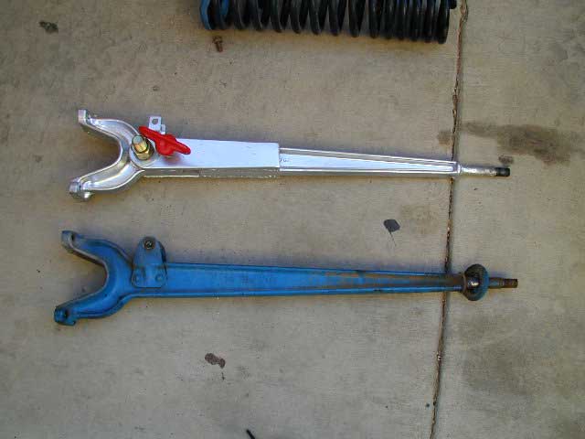

I'd be more tempted to try a "wristed arm"
Common in the Bronco world
the red thing is a pin to lock it out on the road.

QUOTE (MogLite @ Oct 18 2006, 08:40 AM)
Then you may want this
but it's always a compromise,and there's a thread on the P44 BB in which Sam (Strangerover)
suggests not to use it on his own experience...
I never tried one so I can't really say.

QUOTE (Michele @ Oct 18 2006, 08:15 AM)

QUOTE (Hybrid_From_Hell @ Oct 18 2006, 09:44 AM)
and why not use a locking one then ?
Hey Nige!
That's lockable (pin-n-able?),you get out of the truck > un-pin > wheel > get out again > pin
(uhm)
I may have saved the link in my favs,I'll search...!
In the meanwhile check the original page out:
hinged radius arm by Quinn D.(you may already know it,it's a bit dated)

Well, Just back from Slindon.
Had a brilliant day driving around with Graham (Rocker) in the tipping rain!
The missing link suspension performed fantasticly. OK, it leans a bit when you drive, brake or engine brake - but it's not much worse than it was before. I tend to drive technical bits very slowly anyway.
I did most of the day with all the diffs (including the centre) unlocked - and didn't notice. I reckon it has improved the cross-axle capability by about 50%. Theres one bit I failed to drive before, in the dry, which is a serious cross axle up a big steep step. Although I had to use the middle & front lockers - it just gobbled it up!
I think a ram with a remote adjustable needle valve to damp the roll a bit off road and act as an anti-roll device on the road by closing the valve completly - will be an absolute winner!
There are not many mods I've done which in one hit have made such a big difference. Possibly a rear locker - but that's the only one I can think of!
Big smiley!
Si

Did you fit the standard arm to the left to counter act the drive torque? Did it make a difference?

Not swapped sides yet. I think that will make a difference - it will matter less whether I brake or accelerate on left or right hand bends!
The original bolts are about M16 (or some imperial size that's about the same). I reckon there should be less shear force on the single bolt than ther is on it in the original configuration as it is not trying to restrain the axle from rotating.
On a 45 degree side slope, my back of an envelope force resolving calculation gives about two ton shear on the original bolts. The compressive/tensile force on the ram will be about 3 ton for the ram I have.
Cornering hard, the forces could well be higher though.
I think an M16 bolt is probably sufficient - but tell me if I'm way off!

I think youre ok with a single m16 bolt in this application. After all, the three links available dont change this dimension either. What I would suggest is to fit longer bolts in this setup; I remember that the bolts on my axle had the threaded portion in the axle bracket. I replaced these with one size longer, so the shank sits in the bracket and the threaded portion starts just outside the bracket.

M!6 Grade 8.8 will eat three tonnes in shear, especially as it is in double shear. The weak point will be the mounting brackets on the axle - how thick are they?

Daan, you are quite right. The hinged arm should be on the right (drivers) side. The lean generated by prop shaft torque combined with axle roll is quite pronounced.
I've done a bit of road testing today - 30 miles worth - and once you learn how it behaves, it's not too bad.
I have come to an unusual conclusion though. I think what it needs is roll-damping. After all, you rarely if ever need the articulation to happen fast. On the road, it tends to be sudden changes which cause problems as you cannot react fast enough.
Something like this to start with:
I'll mount it across the hinge so the damper moves as the hinge flexes.
It's just a regular ram filled with ATF with rate adjusters on either end - so you can control the compression & rebound separately. Made as a steering damper for the electric bar stool. May turn out not to be strong enough - but will prove the concept.
I mighe even be able to adjust it so the hinged arm exactly cancels torque roll (as per Daan's post).
I think the combination of these might make it a lot more civilised.

The plates on either side of the axle mountings, at the moment are 6mm thick and have a minimum width of 40mm.
The forces action on them are entirely in the direction of max strength/rigidity. I think it looks about right - although, having said that, the Safari-guard 3 link uses 8 or 10mm thick plates so I may be wrong!
I'll try it!
My plan, longer term for the ram is to get a double ended ram made so it has the same swept volume on either side of the piston with a single flow control valve in the middle of a pipe connecting the ports.
I'll remote the knob on the valve into the cab using a speedo cable or similar. That means the hydraulics are quite self contained and you don't have to run any high pressure tube anywhere.
