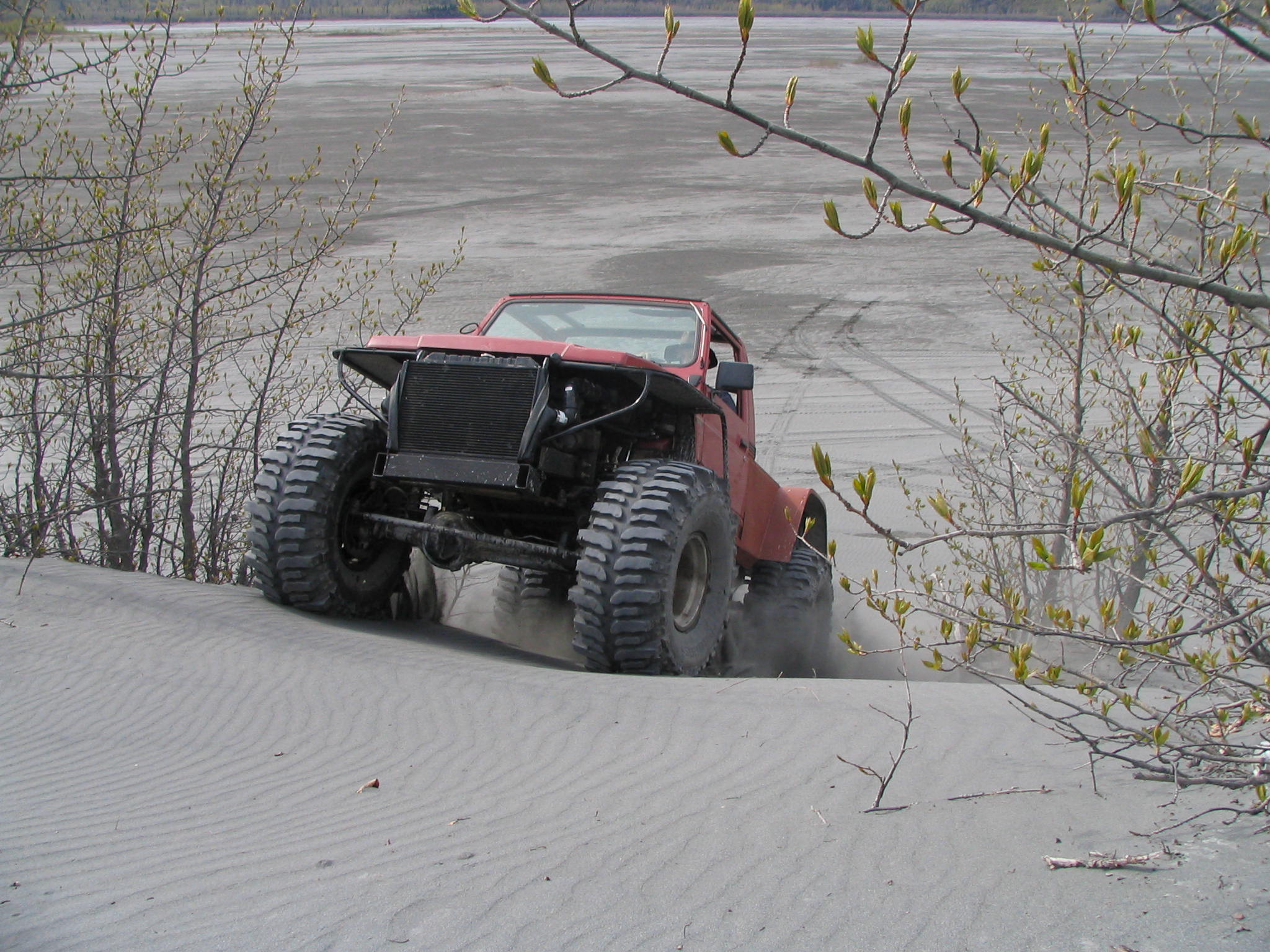

Bull Bar Cowboy Posted June 5, 2007 Share Posted June 5, 2007 A big welcome to Deepmud from the Alaska forum (Wasilla, not a million miles from anchorage) …………… I see him lurking in the background ……….. so I guess its time you posted up Erik……….. This is his baby…………… there’s bits of most things in there including some obscure LR parts ………….. a zuk like you have never seen before……… Ian Quote Link to comment Share on other sites More sharing options...
deepmud Posted June 5, 2007 Share Posted June 5, 2007 A big welcome to Deepmud from the Alaska forum (Wasilla, not a million miles from anchorage) …………… I see him lurking in the background ……….. so I guess its time you posted up Erik………..This is his baby…………… there’s bits of most things in there including some obscure LR parts ………….. a zuk like you have never seen before……… Ian hehe - I've been "outed" here's my odd critter with some other shoes, back when it was "normal" We're following Jez and crew with bated breath over here - I'm glad to hear he survived the "loose wheel" - it sure picked a fine time to leave him! Erik Quote Link to comment Share on other sites More sharing options...

Bull Bar Cowboy Posted June 5, 2007 Author Share Posted June 5, 2007 Good to see you finally here Erik………………….. you have been hiding in the dark and lurking for far too long…… Yes, the old critter might be zuk ………….. but it’s a sami without much zuk left in it ………… passat oil burner………… I have lost count on the rest…….I think 30 spline longs …………. Maybe toy axles…………IM Scout steering ……….. LR steering hose ……….coil sprung ……….. etc………. Normally I think it runs on 39.5 boggers …………………. But here it is on 45 agri’s ………….. are those apples ? Ian Quote Link to comment Share on other sites More sharing options...

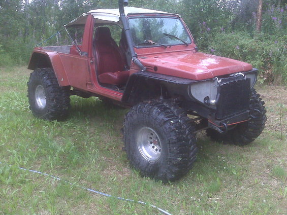

deepmud Posted July 27, 2009 Share Posted July 27, 2009 Hey all - I thought I'd speak up, I still lurk a lot Got 'er running again - I tore it down last fall, working outside until the cold got to be too much, and finished her up just this month,lol. It has a new adapter plate from ACMEADAPTERS.COM, my Beta version was offcenter - it took me a few starters and a couple destroyed transmissions to figure out it wasn't me, it was the plate but Jeff was quick with a replacement when we figured it out, it just took me all winter and most the summer to actually install it. It has new 30 spline Longfields, new 5.29 diffs, a front EZ Locker, and I did the "fozzy-locker" in back - not sure what that might be called or if it's done over there - just weld the valleys of the side gears, 180 degrees apart - the diff is open until it rolls to the filled valley, and jams - sounds SCARY, but has been done to good effect - so I'm trying it out. So far, just bumping around the woods on my property, it's great , lol - it easily turns, doesn't fight the locked rear - but I haven't found enough space to do figure-8's or anything, and haven't had it slam/lock when spinning the wheels in muck, either. Quote Link to comment Share on other sites More sharing options...

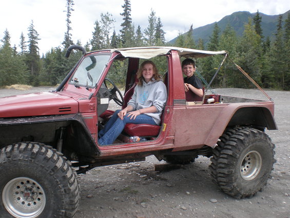

deepmud Posted July 31, 2009 Share Posted July 31, 2009 looking sweeeeet Eric! get it shipped over and come play? Jez I wish I can't even guess at what that would be $$ lol. I did get it out last night, took my niece who is visiting out so she could drive the beast. Quote Link to comment Share on other sites More sharing options...

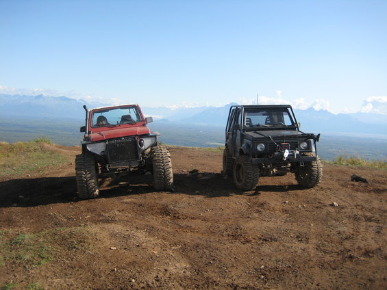

deepmud Posted September 13, 2009 Share Posted September 13, 2009 Got 'er out again - Just a couple pics - the famous "one link" suspension worked great, this was the first rocky trail where I beat on the suspension a bit, lots of deep ruts, two lonnng steep hillclimb up deep-vee gulleys with loose rock/dirt, where I tried all the steepest/ugliest lines with no issues. All was wonderful - except blowing my thread-on high pressure hose line fitting - AGAIN - in the first mile or so. I think the threads on the outer collar cut the hose - add the locker front end, too-long pitman arm from the Scout II box, and the pressure lines keep blowing. Hydro assist will stop this. I was able to strong-arm the trail up and down ok. view near the top - you can see the Knik (Ke-Nick) Glacier way in the back there - that's another fun trail, you can actually drive on the edge of the ice, as long as the river crossing doesn't eat your rig. The black Samurai is my friend AkDale - smart man, his rig hasn't changed in the last 5 years. Quote Link to comment Share on other sites More sharing options...
