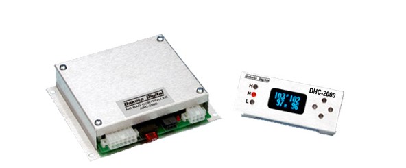

fisha Posted August 8, 2005 Author Share Posted August 8, 2005 it shouldn't really. you pump up each spring till it reaches the required height and maintain that pressure ( which is what the RR effectively does - except it constantly measures the height ) ignoring the compressor and valve setup( cause you would use a RR setup ) , you can easily get: in line pressure sensors for each air bag ( ~$30 each ) a display to show the 4 readings at once ( ~£200 ) then all you need to do is have 4 switches ( 1 per corner ) which can either raise or lower the pressure in each bag by controlling the right valves in the valve block So you load up your car, inflate the bags till you get the right gap between the wheels and arch, and then record each corners value and then manually adjust if one starts to change ( which it shouldn't really if the system is not leaking ) if thats not enough, then you can buy a more advanced system which will allow you to program in 3 height settings ( by the same process as above ) and then the system will automatically maintain the programmed pressure to keep what you've programmed in.... ( ~$800 ) or for the same price . . . yes, the same price ( $800 ) . . . you can get a system which reads the actual suspension height by means of 4 sensors with arms on them. You program in the height you want, and the system will add or remove air in the bags so that the height is maintained . . . .regardless of the weight in the vehicle, or the pressure in the airbags. doesn't that setup sound familiar to a certain RR setup? more investigation needed me thinks. Quote Link to comment Share on other sites More sharing options...

Niall_CSK Posted August 15, 2005 Share Posted August 15, 2005 Donald. As you know I looked at this some time ago but didn't go any further as I was moving the project goalposts too often. I drove the Yorkshire defender with the basic set up and was very inpressed. I have since found quite a few US sites that supply kits, where did you get that info & pictures? My intention was to place a fixed small "bullseye" spirit level somewhere unobtrusive near the physical axle cross centre with the Rangie sitting on the bump stops to zero it to use as a reference, this may also be of some use for the coil problem, it's all too easy to bend a wing or spoiler and then things look off when they are really not. Quote Link to comment Share on other sites More sharing options...
fisha Posted August 15, 2005 Author Share Posted August 15, 2005 Images and prices from dakota digital..... www.dakotadigital.com they do some interesting gauges too. Quote Link to comment Share on other sites More sharing options...
Niall_CSK Posted August 15, 2005 Share Posted August 15, 2005 Thanks Fisha, some very cool gear, could even make a RRC dash look like the USS Enterprise. Don't know how I missed that site, 5 pages down in Google past all the holiday adds as usual. Quote Link to comment Share on other sites More sharing options...
