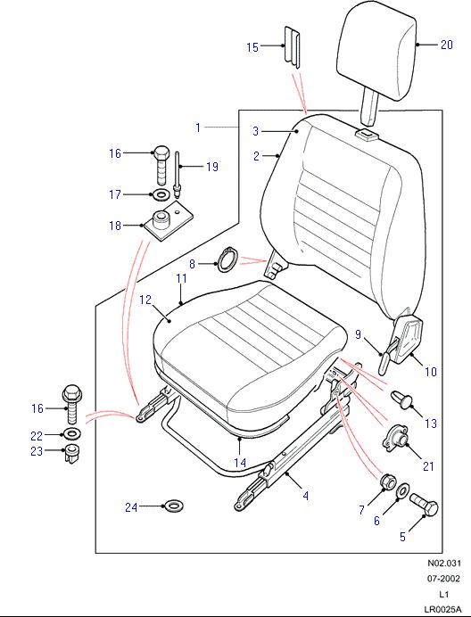

FridgeFreezer Posted April 16, 2007 Share Posted April 16, 2007 Can someone post an EPC piccy or take a piccy of the seats in their defender? I bolted mine down (defender seats on a defender seatbox) but it seems you need a spacer under the runners to allow the sliding mechanism to move - I just need to know how it's supposed to be in a normal defender, is there a stack of washers or a special spacer bit or what? I have used two washers for now but it still seems less than ideal Being a Series owner I'm unaccustomed to this sort of shoddy quality Quote Link to comment Share on other sites More sharing options...

LandyManLuke Posted April 16, 2007 Share Posted April 16, 2007 Microcat only shows one M8 washer. I'll have a look at the 90 later. Quote Link to comment Share on other sites More sharing options...
Happyoldgit Posted April 16, 2007 Share Posted April 16, 2007 Just build it up with washers. Quote Link to comment Share on other sites More sharing options...
Les Henson Posted April 16, 2007 Share Posted April 16, 2007 The fixing bolts are m8 coarse thread, so m8 washers would form a tidy column. The spacers are about 8mm long if I remember right. Les. Quote Link to comment Share on other sites More sharing options...
Happyoldgit Posted April 16, 2007 Share Posted April 16, 2007 This is how Land Rover do it... Quote Link to comment Share on other sites More sharing options...

western Posted April 16, 2007 Share Posted April 16, 2007 washer plain M8 ayf10001L or wa108051L Quote Link to comment Share on other sites More sharing options...
Kev Baldwin Posted April 16, 2007 Share Posted April 16, 2007 Got a ton of those damned seat spacer washers as left-overs from customer MUD Rail installations. I'd be happy to post you out some FOC if you want some? They normally have two spacers/washers under each mounting. Kev Quote Link to comment Share on other sites More sharing options...
