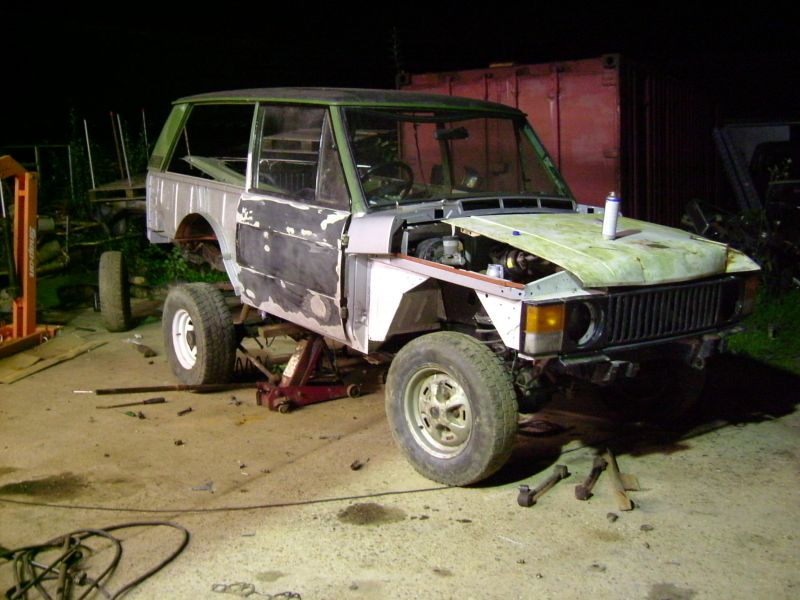

Thanks. I have installed a wider than standard rear axle, the wheels hit the arches before the bump stop touches. I also built slightly taller spring seat perches. Also one bump stop is absent so I need to obtain at least one anyway.
Heres a piccy
