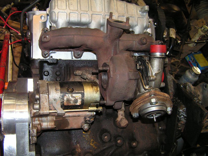

landseb27 Posted February 27, 2008 Author Share Posted February 27, 2008 Carefully cut it at the seam, put the spring underneath. I used exhaust flanges to clamp it together. Some have used small screws or bolts. My control minus one spring on the cable. No boost, full throttle. With boost very , vert thanks , and One last question, did you drill snail to put the hose from depression as in this picture : Quote Link to comment Share on other sites More sharing options...
jimfoo Posted February 27, 2008 Share Posted February 27, 2008 No I didn't drill it. I hooked the hose to the intake manifold. But you could drill it if you want. Quote Link to comment Share on other sites More sharing options...

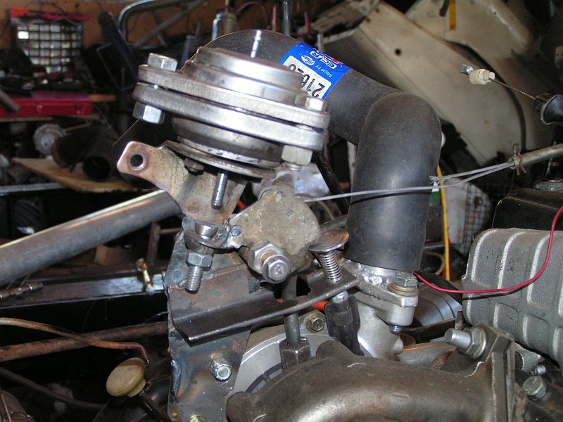

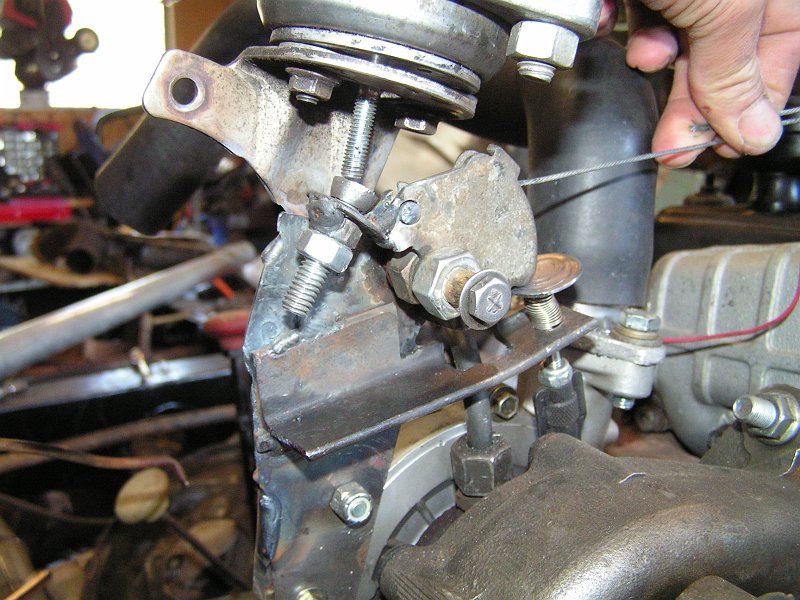

landseb27 Posted February 28, 2008 Author Share Posted February 28, 2008 Good morning, everyone, I think I have understood, please let me confirm: In this photo (photo 1) air arrives on admission ( marker A ), which will commission the stem command turbo (marker B). On the next (photo 2) when it accelerates, the metal (soft C) just press the command turbo (marker B), the stem of the membrane (marker A) does not move, and the fins are open. On the last (photo 3) when the desired pressure is achieved, the stem of the membrane (marker C) supports on the metal part (A marker), leaving the command back fins (marker B) is cut the build up of fins. That is what I understand Quote Link to comment Share on other sites More sharing options...
