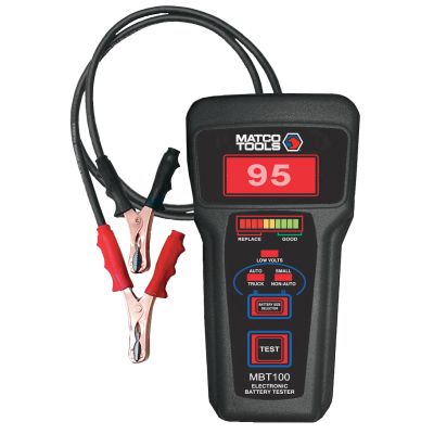

You need to find a battery specialist who has a battery tester - they will have what looks like a large handheld multimeter with alligator clips for positive and negative, attach your battery to it. The good units even have an input for the CCA and Amp/hr values from your battery label. Hit the test button and it will say pass or fail.
Could look something like this:
or
Simply measuring the voltage isn't good enough for a battery test.
