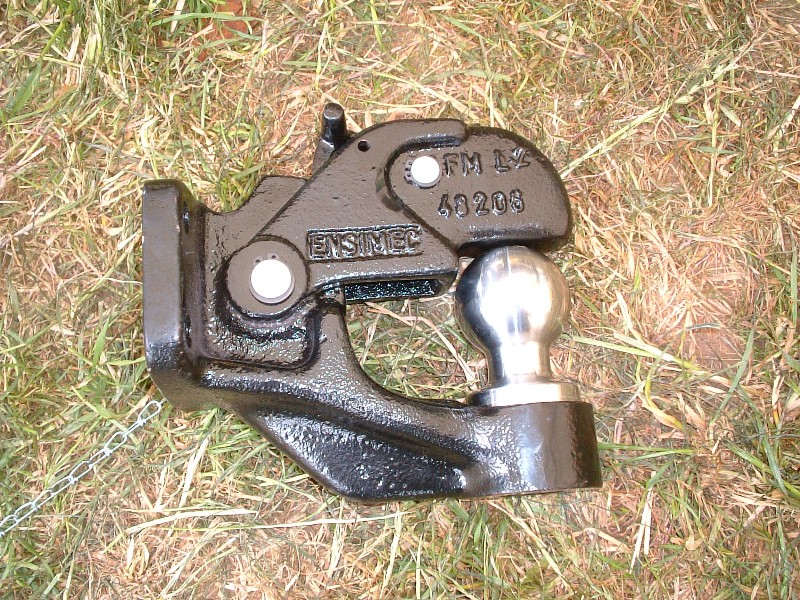

I may be imagining it but I think I have seen a NATO style hitch with a 50mm ball cast onto the top part of the hook - such that the ball can be used while the hitch is in it's open position. Could have been a dream though.

No your right
I have see one of those to don't ask me where
Sue (Series mod on LRA) - her parents bought one for their TD5 130. She'll know where they got it from etc.
They are an impressive bit of towing equipment, and I believe are as strong as a standard NATO hook (54-tons?)
Les. :)
Nah it is a mere 22 tons!
You can buy them here, ball bolts on to the jaw part, no idea who makes them though. Bout 74 quid here I think

Strangely, these were on sale ay Gaydon last year! Can't remember who :( wasn't one of the big boys.
Seem to remember they were made in Brazil. When I had a fiddle with it :blink: I found the pin or something wouldn't locate or something, when I pointed this out the guy tried and he couldn't either a little embarrassing for him as he'd just spent 5 minutes telling what a perfect bit of kit they were!
I think about £90 may have been over £100.

'Tis all true..... although it's a 2" ball not 50mm which I once found out to my disgust...... :angry:
Do you know how to tell a 50mm ball from a 2" one?
The 50mm balls all have a flat on the top, the 2" ones do not. Easy.
The one in the Sparex picture looks easily changed.
