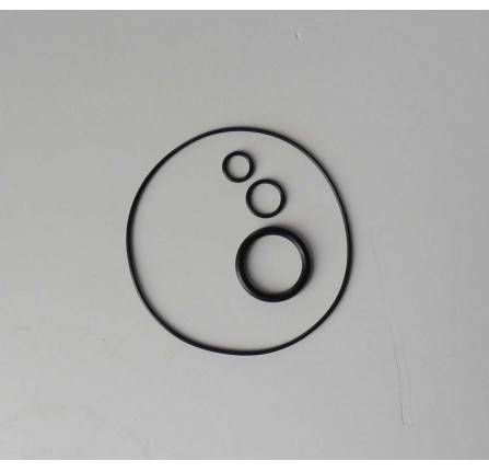

The manual for the overdrive lists the part as RTC7166, which translates to an o-ring service kit like this:
http://www.johncradd...t_overdrive.php
So, is it as simple as replacing the o-ring? Or is it like the LT230 intermediate shaft problem, where it will just come back?
