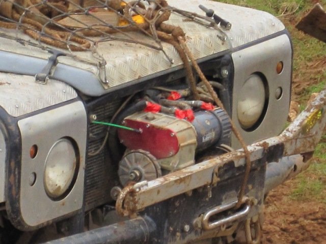

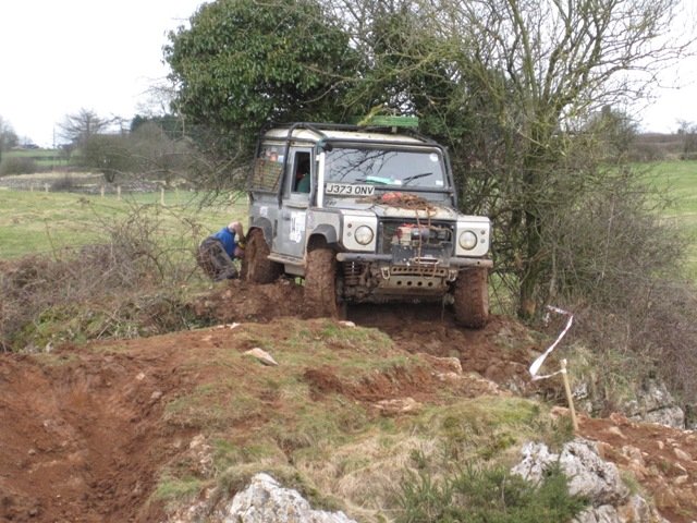

smokinv8 Posted December 29, 2010 Author Share Posted December 29, 2010 Thanks fellas I'd forgotton about North Offroad. Zardos, dont suppose you have a picture of the front of your truck showing the lights etc? Quote Link to comment Share on other sites More sharing options...

zardos Posted December 29, 2010 Share Posted December 29, 2010 Close up of the lights A bit further away Quote Link to comment Share on other sites More sharing options...
