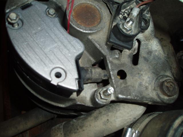

- You can now lift and rotate the alternator, to get to the back.
- The regulator is secured by three bolts, The bolt heads are 5.5mm
- You need to disconnect the regulator supply wire (pictured), which is a spade connector.
- the regulator/brush pack can be removed by rotating it slighlty and withdrawing it from the housing.

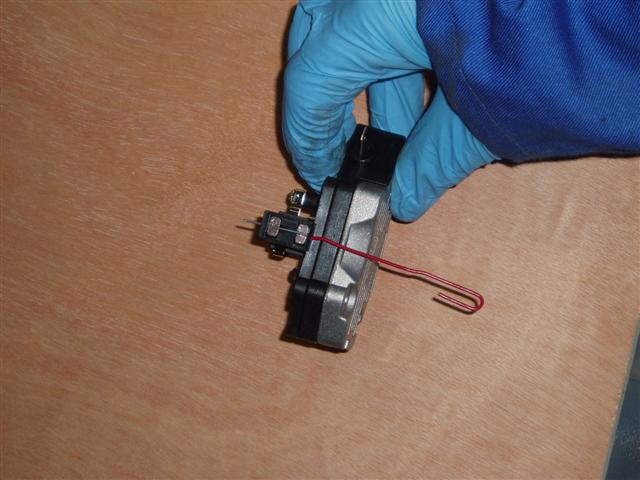

- It's worth checking for excessive wear where the brushes make contact with the rings on the shaft.
- Insert a straightened paperclip through the brush housing to hold the brushes in. this prevents damage to them on fitting.
- Connect the feed wire.
- bolt the regulator pack on.
- remove the paperclip, after bolting the regulator down.
