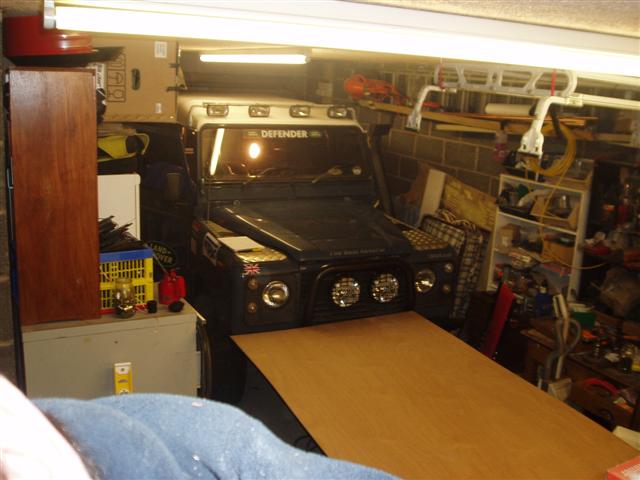

I have to take my tyres down to about 10 psi to get the 90 into the garage. i have about 1/4" to 1/2 clearance.
Once the 90's in, i blow the tyres up again, and i've got about 12" clearance, been thinking about getting a roller door.
Picture showing the 90 and a full size sheet of ply....:)
I'd move the ply - you'd have alot more room to work!! :ph34r:
The 90, and the ply, were in the garage as i was making a new bit of dash, there was plenty of room once i'd cut into the ply and moved the big bit out of the way! it was £13 for a whole sheet, or £9 to have a half cut, no brainer as far as i was concerned. going to use the rest to panel out the hardtop.
